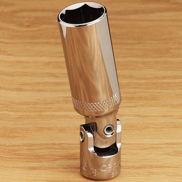

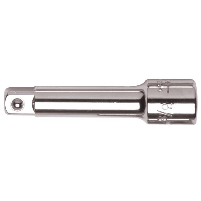

used:
3/8 Rachet Ergo flex MFR # 44836
3" 3/8 Extension MFR # 44264
6pt Flex Spark plug socket, (5/8")

Originally Posted by -=Jeff=-
fairly easy
used:
http://s7.sears.com/is/image/Sears/0...arpen=1&qlt=75
worked out well
Before going to BG, I replaced my NGK TR55 with AC 41-602s. #8 was a pain. Finally got it with 5/8" socket with universal and 3" extension then using a breaker bar to have enough room between extension and heater box. BTW, at the Midwest Gathering, Mark H. suggested using
