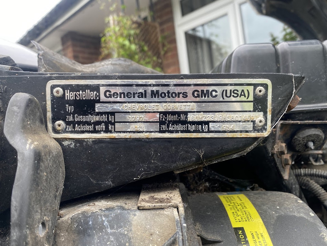

I'm sure this crew would be incredibly thankful for anything European export specific you can document. The metal identification plate near the right hood latch was one I had not seen before if you would be able to get a close up of that.

I haven?t managed to do any proper diags yet - We have a Tech 2 for the C5 but I?m totally unfamiliar with OBD1 and what I?d need to access the data? I?ll read up on the links you sent!
I?ll post the vin plate next time I?m on a computer!

Photo of the vin plate as requested ! If anyone wants to see anything else in detail please ask !
