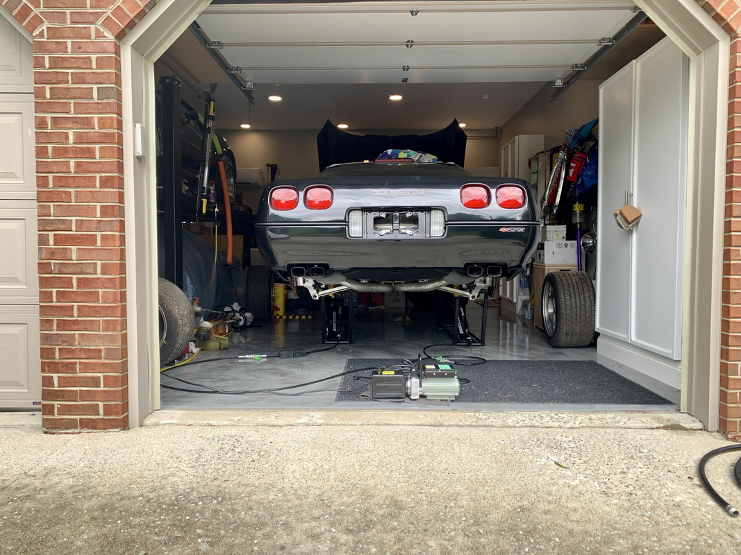

Hmmm, I am not sure how our cars can be different. Here is a screenshot of a video with mine being lifted at the V-2-V mounting end brackets. The lift is no where near the floor boards. In fact, my car has 49th Street rockers (aka Blue Flame Restoration rockers) but with QJ blocks I clear everything. ???
Attachment 16078
Just took some quick measurements. I measure the floor pan 1" lower than the pinch welds. The thicker Quickjack blocks only sit 1 5/8" above their pocket on the jack frame. Between the general flex of the blocks & the pinch welds sinking into them, that 5/8" disappears quickly. I'll take picks next time I have it in the air. Good to know the V-2-V braces can be used with the Quickjack.
Okay, got it now. You do not have V-2-V no flex bars and you are saying that QJ does not work well on C4s or too close for comfort to lift the car properly. Sorry, I am slow and missed that the first time.
