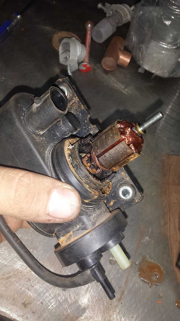

Hi,
I had a Code 61 for exactly 3 seconds this afternoon. So I tried to figure what is the problem.
When I put the key ON, I don't hear the vacuum pump. So tonight.
1st of all, I unplugged the vacuum pump and test the connector with a multimeter. Ground is OK, however I don't get any signal from the brown wire. I asked somebody to put key off/on while I read the multimeter, still nothing.

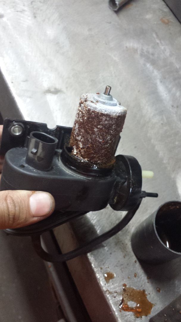

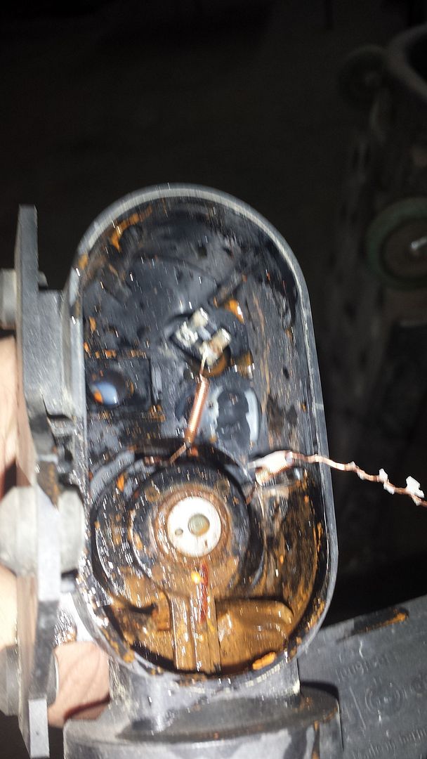

2nd of all, I opened that vacuum pump. What a mess! I don't think I can fix that now. It was full of rusty water.
So I put everything back on, I know for a fact that vacuum pump doesn't work.
I then went for a strong 10 miles ride, car runs like it should. Very strong at high RPMs. No SES light (erased previous Code 61).
Now I am very confused.
1. Why I don't have any current coming in the connector?
2. Why is the car running fine without the vacuum pump working?

WOW.. Looks like water intrusion for sure. You may want to check all electrical connectors, clean and apply some dielectric grease to them.
I knew there was something wrong when I opened it and it was full of rusty water...
