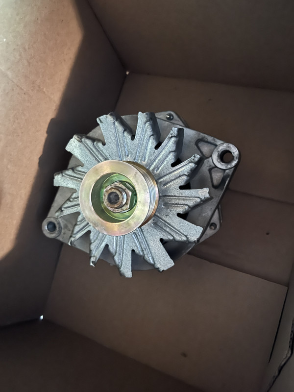

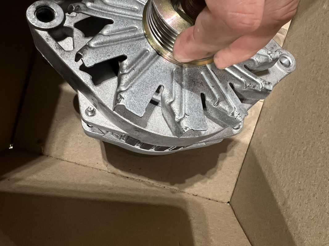

A new learning, as of this morning?someone (probably prior owners repair guy; don't know who) put an alternator on that did not have the appropriate "clearance"; it caused undue tension/friction on the belt.
Not certain that contributed to the situation at hand?but, is something that was "off", that will now be fixed. One more problem resolved!

Alternator clearance? Can you be a bit more specific? Sounds a bit odd. Is this what your mechanic is saying?
Yes, the teeth on the alternator were impacting some mount. I'll take pictures later, when I head back over to pick up some old parts.

Default Re: Cautionary tale: power steering system/steering shaft failure leads to bad situat
Alternator teeth? Are you referring to the fan blades behind the pulley?
Yes, sorry, the fan blades. They were impacting a mount piece. Altered the physics of the belt, etc.
