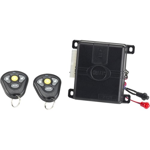

Pete, Dom,
I have the Valet 712t, wires the same as the old GM VKE1000, but under 1/2 the price.. the one I have is under $50..
http://www.amazon.com/3-CHANNEL-Keyl...5791554&sr=8-1
Works great and is keyless only, no alarm just like the OP set-up
