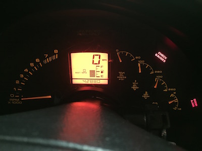

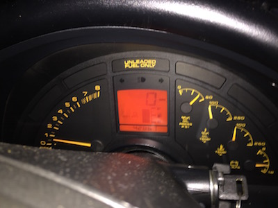

I just had my 1992 instrument panel repaired and wanted to share the results.
Before: The LCD was terribly faded and I could barely make out the letters & numbers. It took a lot of the enjoyment out of the drive.
After: Wow! What a difference (even with my horrible photography lol)
A big shout out to Bryan Thompson at http://batee.com for the great work! $299 to replace the polarizing film, replace LCD connector, install a new set of bulbs, and repair a wiring harness connector. I highly recommend his service.
