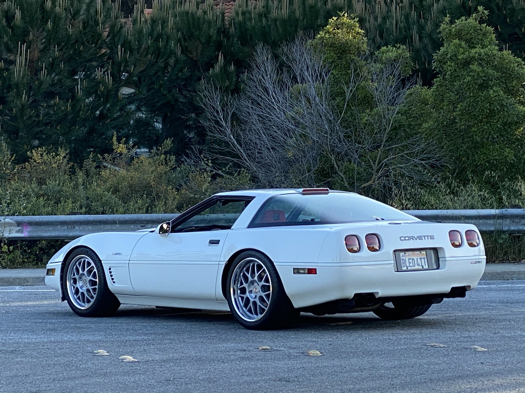

I've already stated on the other site,for that kind of money I'd keep looking. For $30K you would be able to find a car with under 10,000 miles. Here's some motivation for you. [IMG][/IMG]
