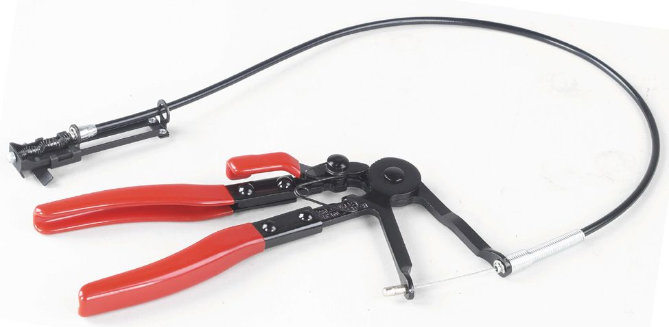

Make sure the craftsman tool you get is the remote one, the one on the long cable. Not the one that is pretty much like a set of normal pliers, just with a different end on it. Some of them clamps can be in odd positions, and the remote tool helps a lot with that.

Aurora, not familiar with the tool you describe. They only have the plier like set....I'll check NAPA & CarQuest...

They look like this:
They might also have them from SK if they carry that locally, though the SK ones are more expensive (though probably better quality).
