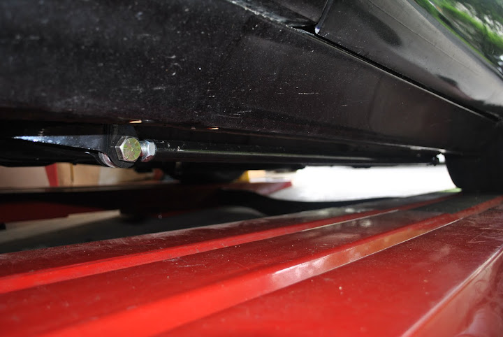

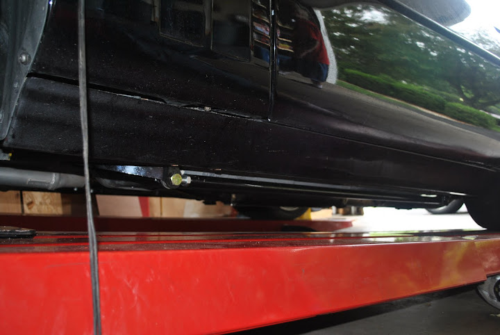

Currently on my Car are a set of frame brace to help give the C4 a solid frame feel like the C5. These will bolt in any post-86 (uses front X brace bolt points), no drilling required, although there might be an extra hole in the brace that would require one hole to be drilled but would be optional. These braces can be left on while removing exhaust ETC, it is not a cross brace of any type.. The Brace was designed by Gordon Killebrew..
These braces are NOT lower then my exhaust. they are similar to F-body Sub frame connectors (in mounting) and are not X-Braces
So far I have driven 100 miles with the top on but the car is definitely more solid then it was prior.
Need to drive with the top off to see how well it is
in the picture below the car is dirty from rain..
you can see the head of one bolt here on the left and the rod (in black) running length of car..

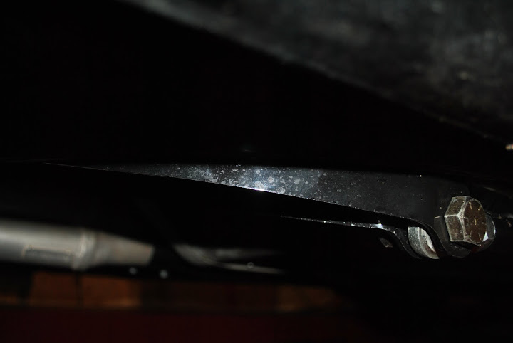

REAR Mount:
Front Mount:
