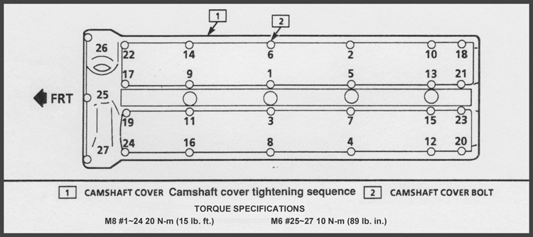

Originally Posted by tommy View Post
I checked cam cover today and it looks good.Last time I tightened the screws by torque wrench M8 bolt 20Nm and M6 bolt 10Nm. Whether tightening order is important?
Yes, sequence is important. Not only to sealing but also for the camshaft journal bearing alignment.
