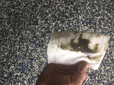

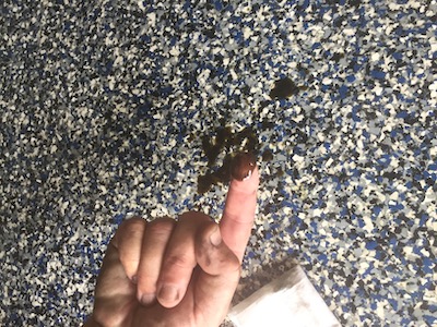

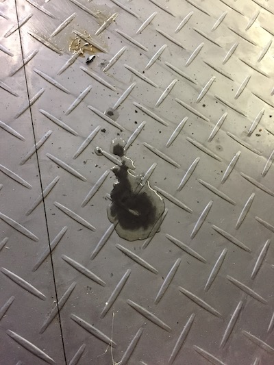

When the car is cold and moving, I hear an intermittent clunk/click that's driving me crazy. When it happens, you can feel it in the steering wheel. When things warm up, like by the time I get out of my driveway, problem goes away. I first thought it was the brakes binding but I think now it might be a bad U joint or bad spline? The half shafts looked okay but the rear seal seems to be leaking badly. We checked the rear fluid level and to my untrained eye, this oil looks like it really needs to be changed:
http://www.cruzeware.com/1992-043/info/Rear1.jpeg

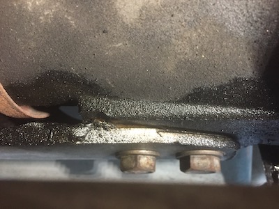

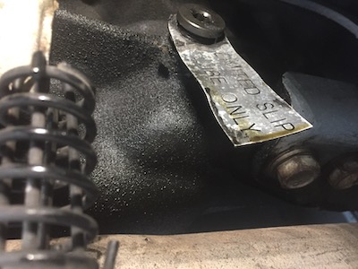

Here's a couple pics around the rear seal area. The cover and the surrounding area were very wet.
http://www.cruzeware.com/1992-043/info/RearSeal1.jpeg
http://www.cruzeware.com/1992-043/info/RearSeal2.jpeg
Should I plan on replacing the seal and seeing what else might be wrong when I'm in there?

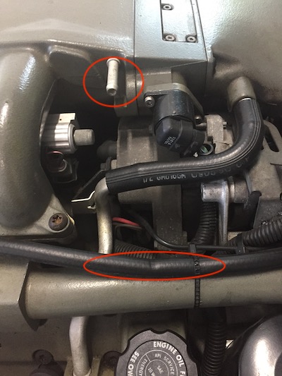

Issue #4 -- what's this port?
A question, really. This port looks like it needs some kind of hose attached. There's a matching port on the other side of the plenum. It looks like someone re-routed the hose so it now goes around the front of the plenum? Wondering what should be hooked up to this port and if it might be contributing to issue #3?
http://www.cruzeware.com/1992-043/info/Outlet.jpeg

Issue 4.. is was for Coolant to keep the TB warm for cold days.. it is bypassed on your car.. typical mod..
Issue 2.. the front pinion seal seems to be leaking, Might be good to have the differential checked when the seal is replaced, assuming the unit needs to come apart for the replacement of the seal. The clunk could be a u-joint

That makes perfect sense: the car came out of FL originally, but I bought it from someone in NY who was road racing the car. Car is now back in FL where it belongs ;-)
