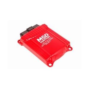

I came across this MSD ignition module and was wondering, has anyone used it and it worked?

Kurt,
Looks neat, can you please provide the MSD part number and where can the specs be found on the this unit?

I ordered one earlier today, should have it early next week and will post up what i discover. keeping my fingers crossed.

my best guess is you will need a different crank trigger to get it working right
that 9 notch trigger wheel in our cars is the issue
did you order the 6011 or 6013?

Re: Possible igniton new MSD Ignition module
Looks like 6011
Read the instructions. It's a Ford controller. Not holding my breath.
It was a no go, the internal schematics are so different that it will not be close. I returned it.
Back to the drawing board.
