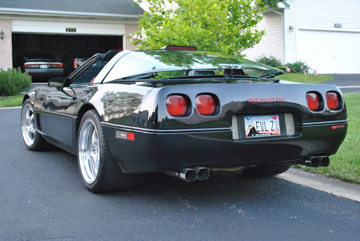

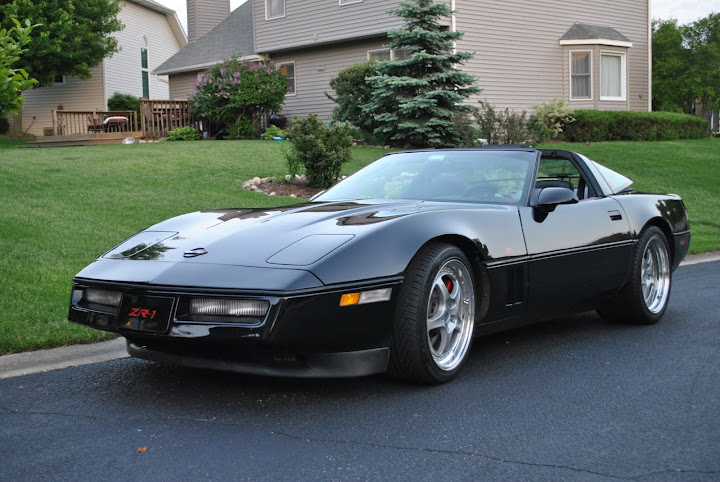

I have mine like Locobob's with the centers on the outside:
http://lh5.ggpht.com/_N1g6599TmMo/S_...0/DSC_0220.JPG
http://lh6.ggpht.com/_N1g6599TmMo/S_...0/DSC_0218.JPG
http://lh3.ggpht.com/_N1g6599TmMo/S_...0/DSC_0217.JPG
Z51JEFF 09-02-2010 06:15 PM
Re: A question about Shelby Series One wheels.
Are the centers cast and if so is there enough material to machine of a touch?There alot of wheel on the market just are just too busy,got too much crap goin on but I like these.Kickin myself for no buying a set when they were dirt cheap.These wheels look just as good as some of the $5000 wheels some companies have on the market today.
-=Jeff=- 09-02-2010 06:43 PM
Not sure if there is enough but I guess it depends how much you want to shave off
Here is what I had saved from a post somewhere on the Net, I think it was CF, but could have been here
Well I did the test fit and here are the results:
Fronts (measured from brake rotor face to outside lip of wheel)
Stock = 9cm
Shelby = 10cm
Diff = +10mm
Rear (measured same)
Stock = 14cm
Shelby = 15.9cm
Diff = +19mm
Wheels stick out too far so I tried a modification which LocoBob suggested.
I put the center sections on the outside instead of the inside of the wheel joining surface. Center section fits like a glove on either side...
Here are the results:
Stock = 9cm
Shelby w/mod = 9.3cm
Diff = +3mm
Stock = 14cm
Shelby w/mod = 13.5cm
Diff = -5mm
I added my 1/4 inch spacer to the back:
Stock = 14cm
Shelby w/mod + 1/4 inch spacer = 14.4cm
Diff = +4mm
