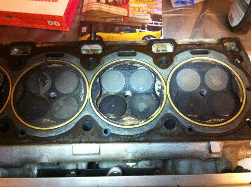

we got it out and I went ahead and cleaned the shop and pulled the sick head off,..We were all hoping that the issue was just a broken timing chain and a couple of bent valves,....BUT!..........
http://i917.photobucket.com/albums/ad18/oricale/062.jpg
THAT EXACTLY WHAT WE FOUND!!!
http://i917.photobucket.com/albums/ad18/oricale/064.jpg
OTHER than a few dings in the pistons and some broken plastic,...this is what we have...
http://i917.photobucket.com/albums/ad18/oricale/063.jpg
Moving forward..
A BIG THANKS AGAIN TO MY WAZOO BRETHREN!
RICH,PAUL AND PHIL!!!!:cheers:

So what did you guys find?
I see a couple of exhaust valves need replacing,what else.
Pete
bdw18_123 01-29-2012 04:38 PM
Re: Getting ready to pull the engine!!!!
Looks very similar to what mine looked like, although it looks like yours happened at a higher RPM than mine because the valve marks in the pistons on mine weren't nearly that big.
